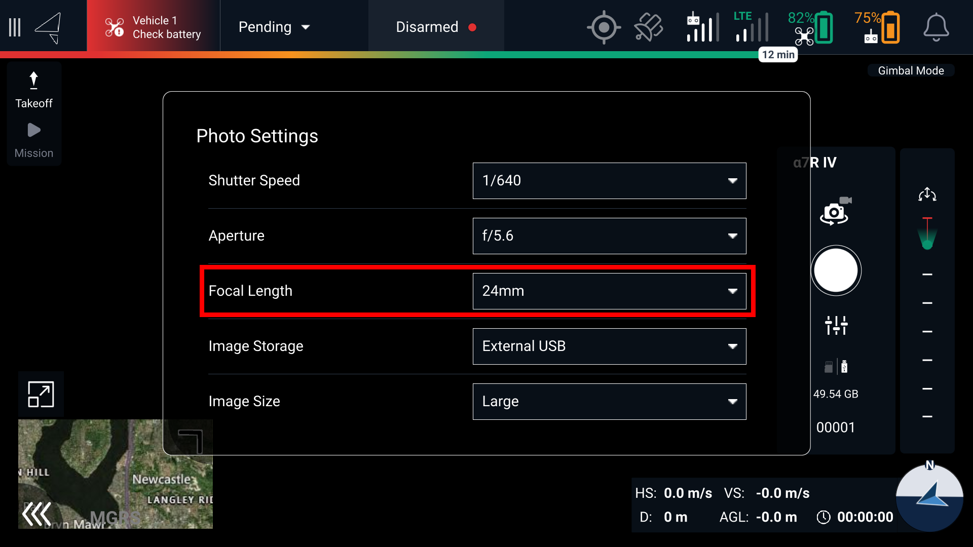

2\. Open the camera view for the payload, and select the settings <img src="https://2546427254-files.gitbook.io/~/files/v0/b/gitbook-x-prod.appspot.com/o/spaces%2FWXREyAKYAeQJ4gfg2SPg%2Fuploads%2Fgit-blob-42a429aeab4757164c9cac16ca392647dde6a1d8%2FSettingsIcon.png?alt=media" alt="" data-size="line"> icon. Select the lens that matches what you're using (default 24mm).
<img src="https://2546427254-files.gitbook.io/~/files/v0/b/gitbook-x-prod.appspot.com/o/spaces%2FWXREyAKYAeQJ4gfg2SPg%2Fuploads%2Fgit-blob-ed0980be46b06d41ef32f36c1b04201d8765a4c4%2Fphoto_settings_2%20(1).png?alt=media" alt="" width="563">

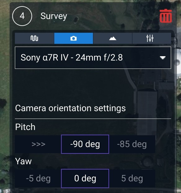

4\. In the Pattern/Survey waypoint settings, open the Camera tab, and select Preset: Sony ILX-LR1 - 24 mm SIGMA.
<img src="https://2546427254-files.gitbook.io/~/files/v0/b/gitbook-x-prod.appspot.com/o/spaces%2FWXREyAKYAeQJ4gfg2SPg%2Fuploads%2Fgit-blob-7f7da5cdd4869084da5c110ccfded9a35489cfbe%2Fimage%20(125).png?alt=media" alt="" width="292">

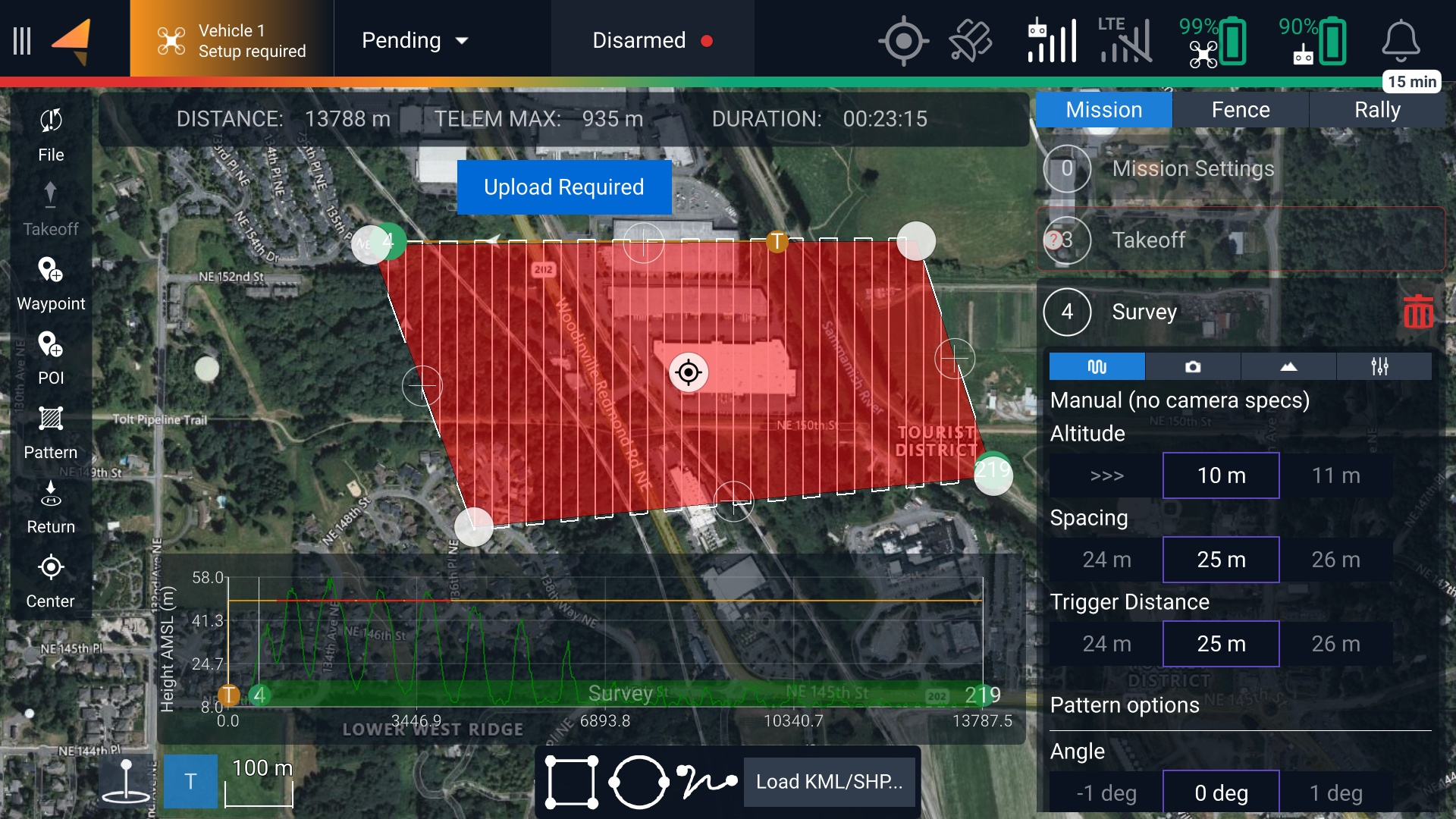

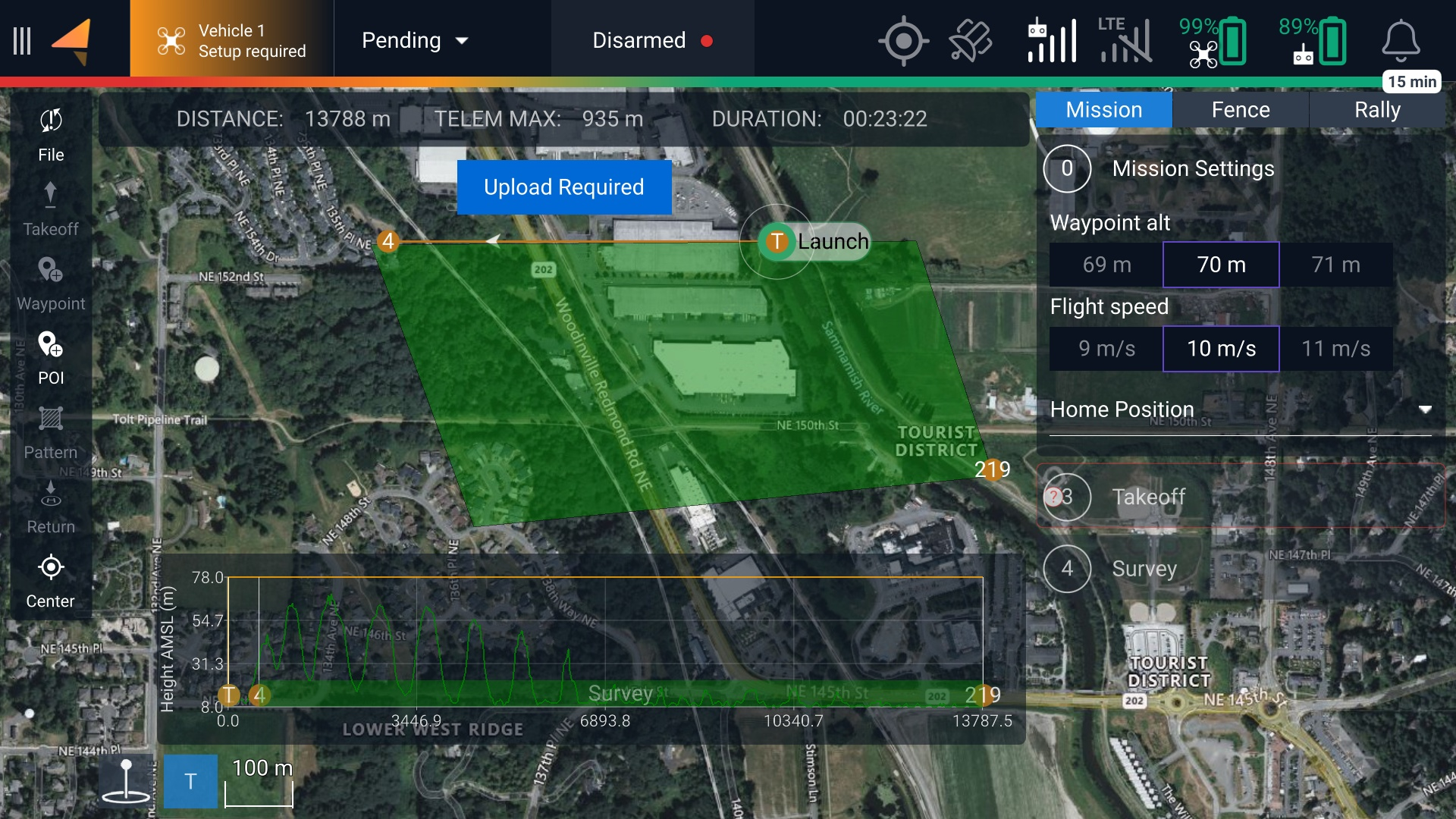

6\. Turn on Terrain Display by selecting the square T button in the bottom-left corner. Check the heightmap to make sure the flight path clears the terrain by a comfortable margin.
<img src="https://2546427254-files.gitbook.io/~/files/v0/b/gitbook-x-prod.appspot.com/o/spaces%2FWXREyAKYAeQJ4gfg2SPg%2Fuploads%2Fgit-blob-846b2e8a0f8875552e7df77f424dc83e1ef8be3a%2Fimage%20(142).png?alt=media" alt="Height map at the bottom shows terrain in the area is higher than the mission altitude." width="563">
<img src="https://2546427254-files.gitbook.io/~/files/v0/b/gitbook-x-prod.appspot.com/o/spaces%2FWXREyAKYAeQJ4gfg2SPg%2Fuploads%2Fgit-blob-7dbdb1c23af85902ed0920c6ee0fd2fab7992bc4%2Fimage%20(127).png?alt=media" alt="Altitude of the mission was increased from 50m to 70m, avoiding the terrain." width="563">

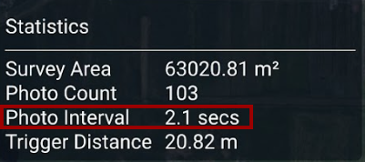

7\. Set speed. Check the Photo Interval value at the bottom of Survey settings along the right. This interval needs to be 2 seconds or more. If it's less, decrease the mission flight speed or increase forward overlap (if this is acceptable for your mission). If the photo interval is larger than 2 seconds, you can optionally increase your flight speed.
<img src="https://2546427254-files.gitbook.io/~/files/v0/b/gitbook-x-prod.appspot.com/o/spaces%2FWXREyAKYAeQJ4gfg2SPg%2Fuploads%2Fgit-blob-c275c64eef01390685b299beb28dff7305e7b0d5%2Fphotointerval.png?alt=media" alt="" width="301">
8\. Adjust the Pattern area. Make sure the green area (the area to be flown and photographed) is larger than the map you need. Make the green area larger on every side by at least the width between flight passes. Note the estimated flight duration at the top of the screen. If the duration is longer than 23 minutes, it's likely to require a second flight.

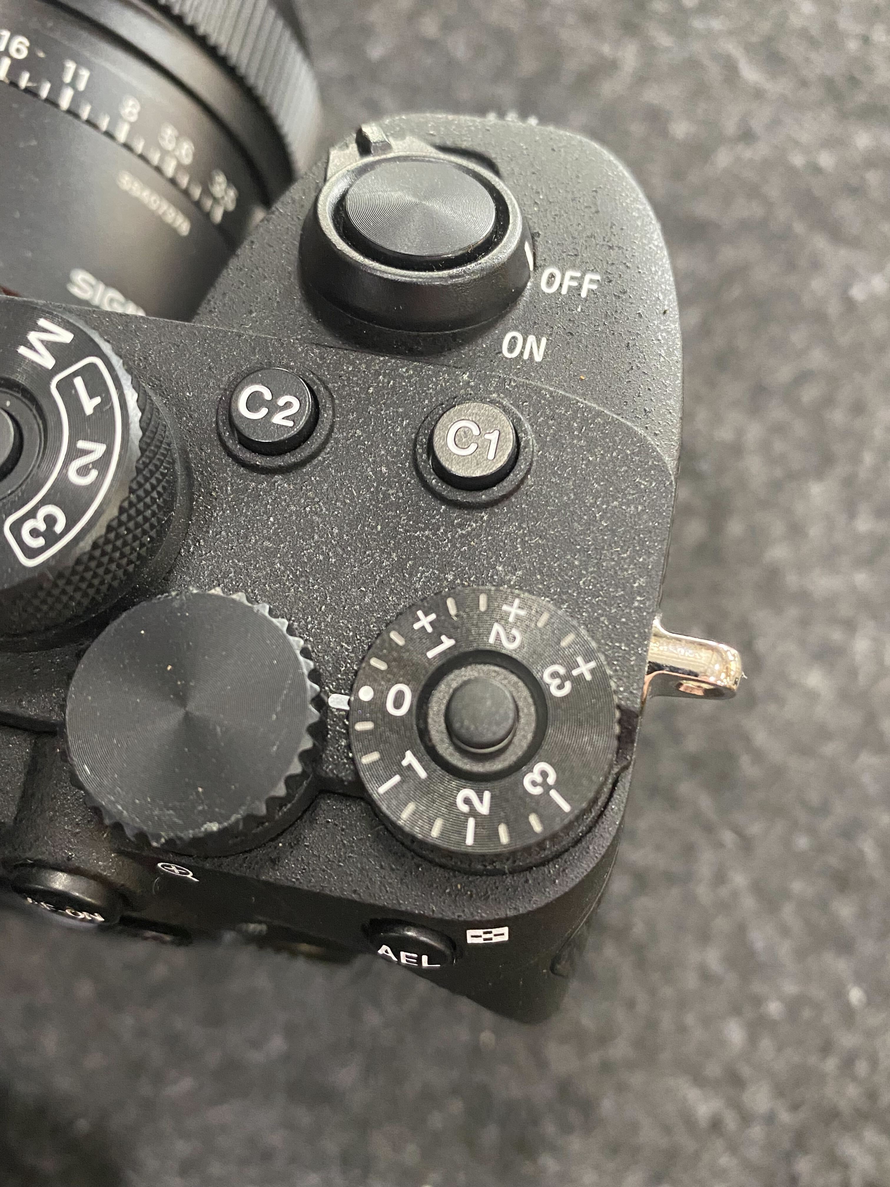

* Body Exposure Compensation Dial: 0, and the lock button engaged
<img src="https://2546427254-files.gitbook.io/~/files/v0/b/gitbook-x-prod.appspot.com/o/spaces%2FWXREyAKYAeQJ4gfg2SPg%2Fuploads%2Fgit-blob-f467d797830281f94065b302537be3434a99c9e8%2FIMG_9519.jpg?alt=media" alt="" width="375">

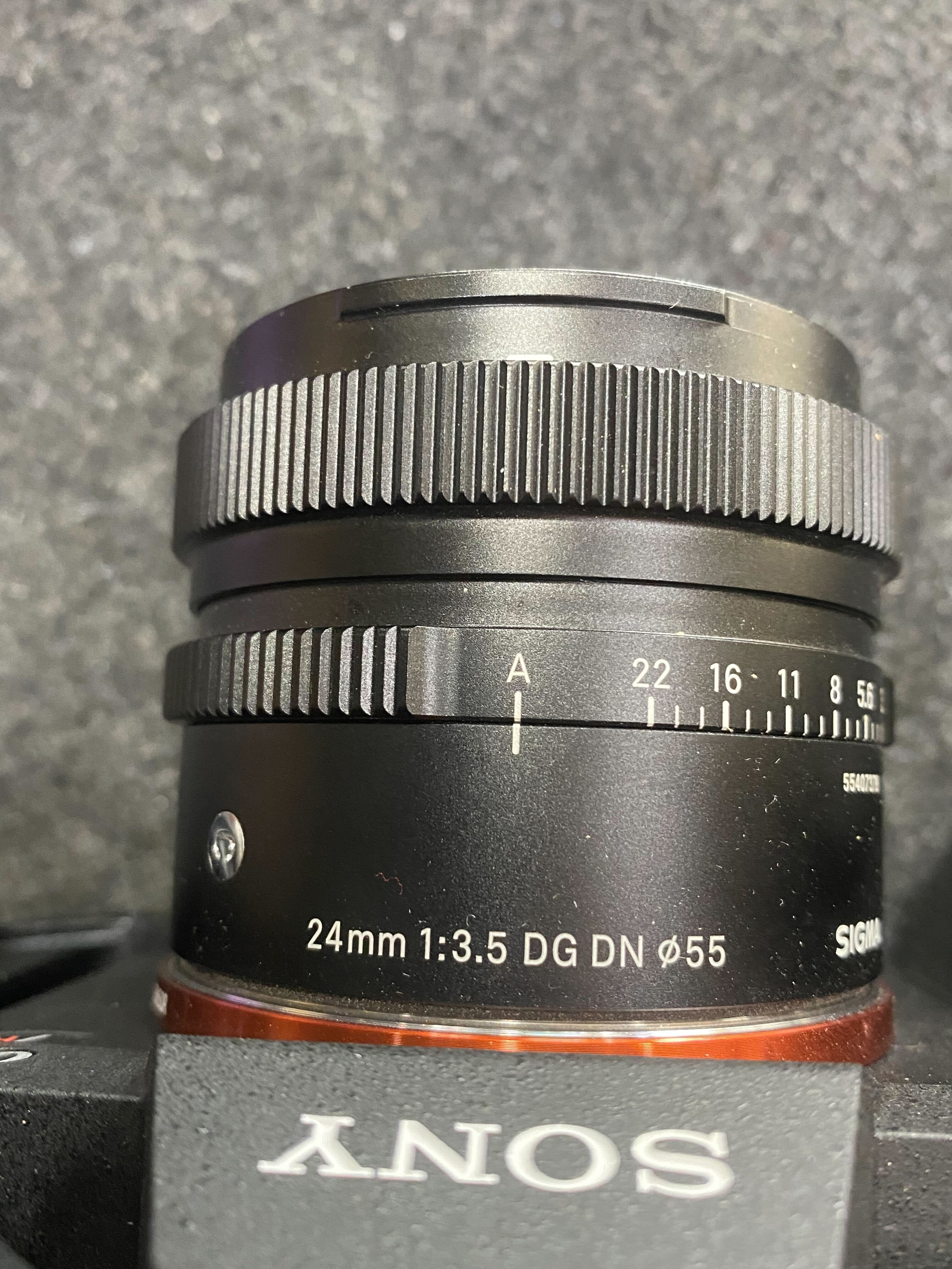

* Lens Aperture ring: A
<img src="https://2546427254-files.gitbook.io/~/files/v0/b/gitbook-x-prod.appspot.com/o/spaces%2FWXREyAKYAeQJ4gfg2SPg%2Fuploads%2Fgit-blob-fe8847f3510686a23d24dedffe7c2f400dd6dec8%2FIMG_9520.jpg?alt=media" alt="" width="375">

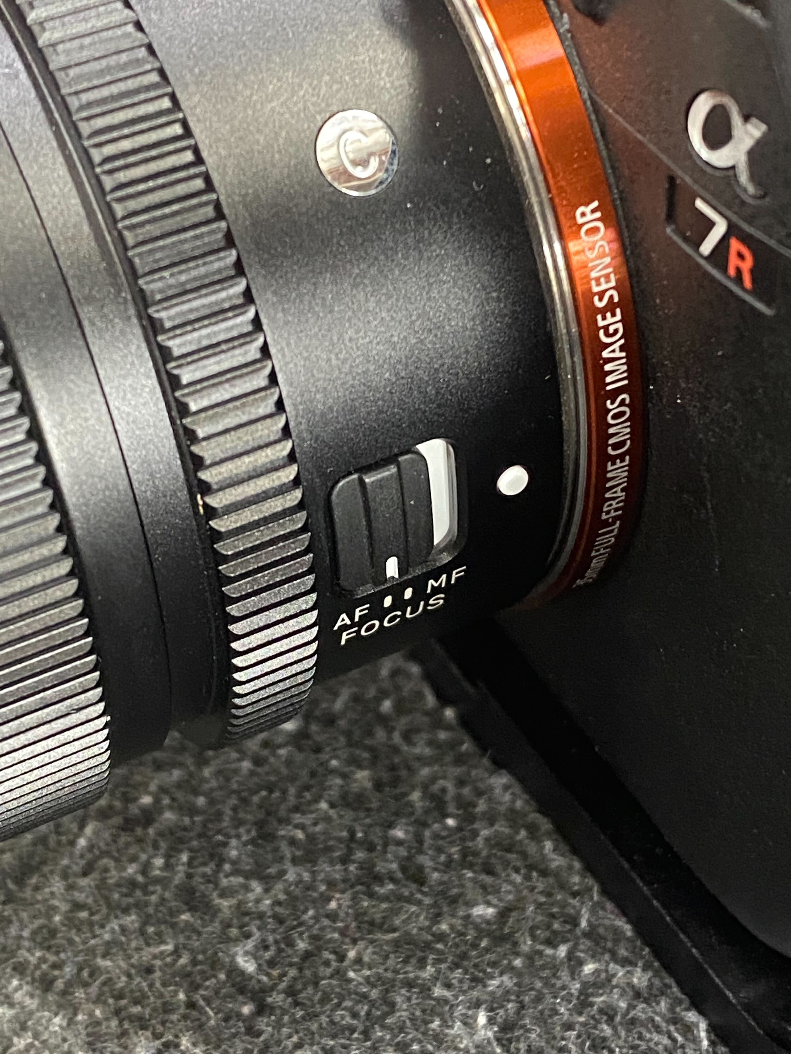

* Lens Focus switch: AF
<img src="https://2546427254-files.gitbook.io/~/files/v0/b/gitbook-x-prod.appspot.com/o/spaces%2FWXREyAKYAeQJ4gfg2SPg%2Fuploads%2Fgit-blob-5de246b248b8609b376ab7fa87ef7892d35887c9%2FIMG_9521.jpg?alt=media" alt="" width="375">
