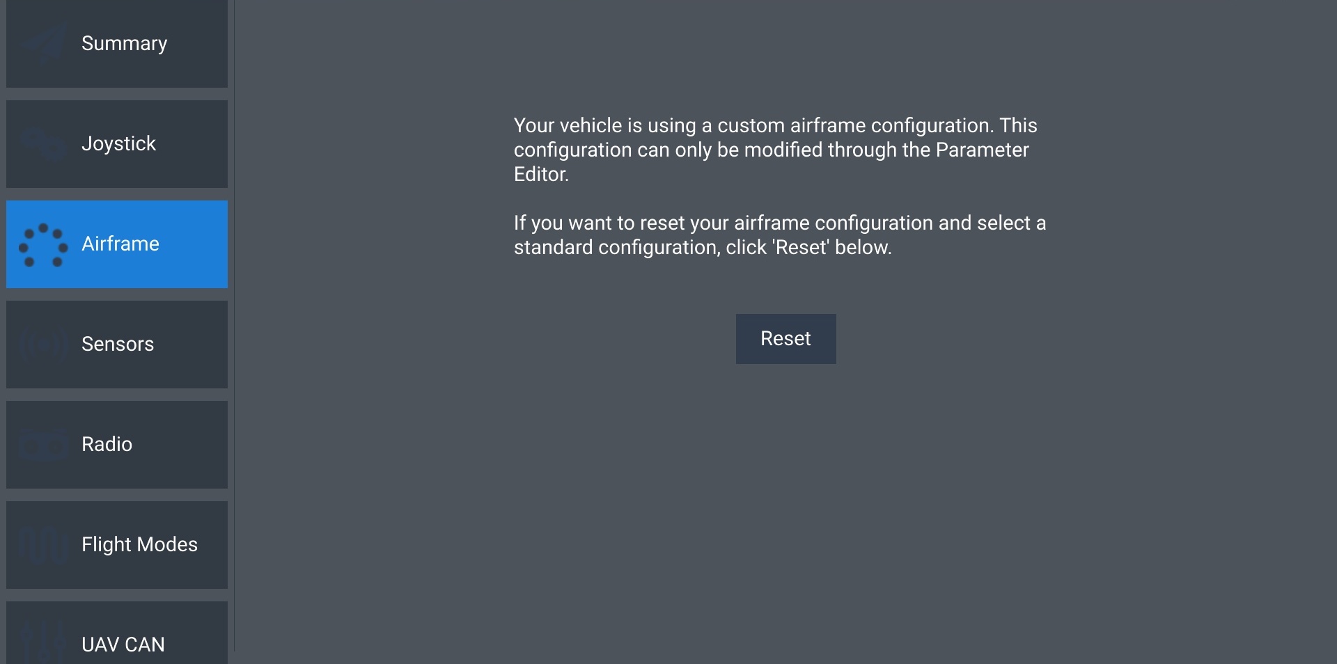

Advanced Airframe

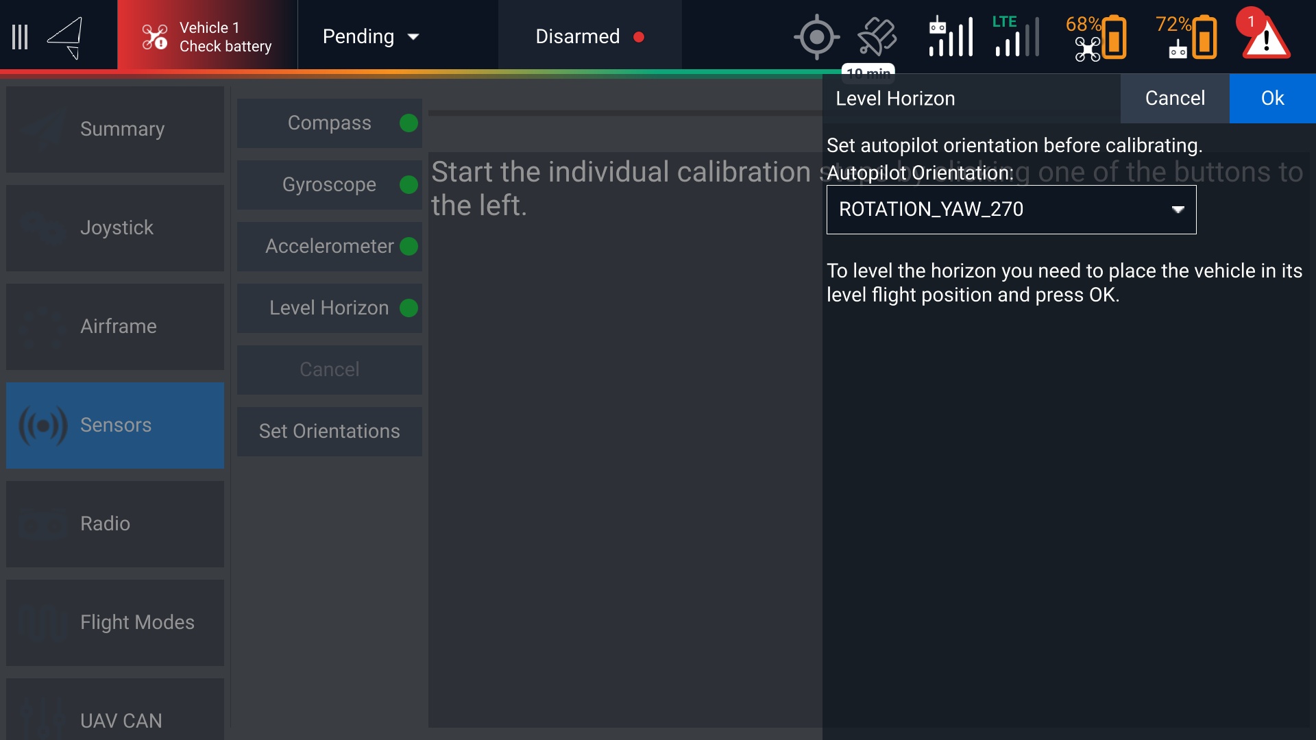

Advanced Sensors
Be very careful about the Autopilot Orientation setting when calibrating sensors in Advanced Mode. It should not be changed from the default value of ROTATION_YAW_270.

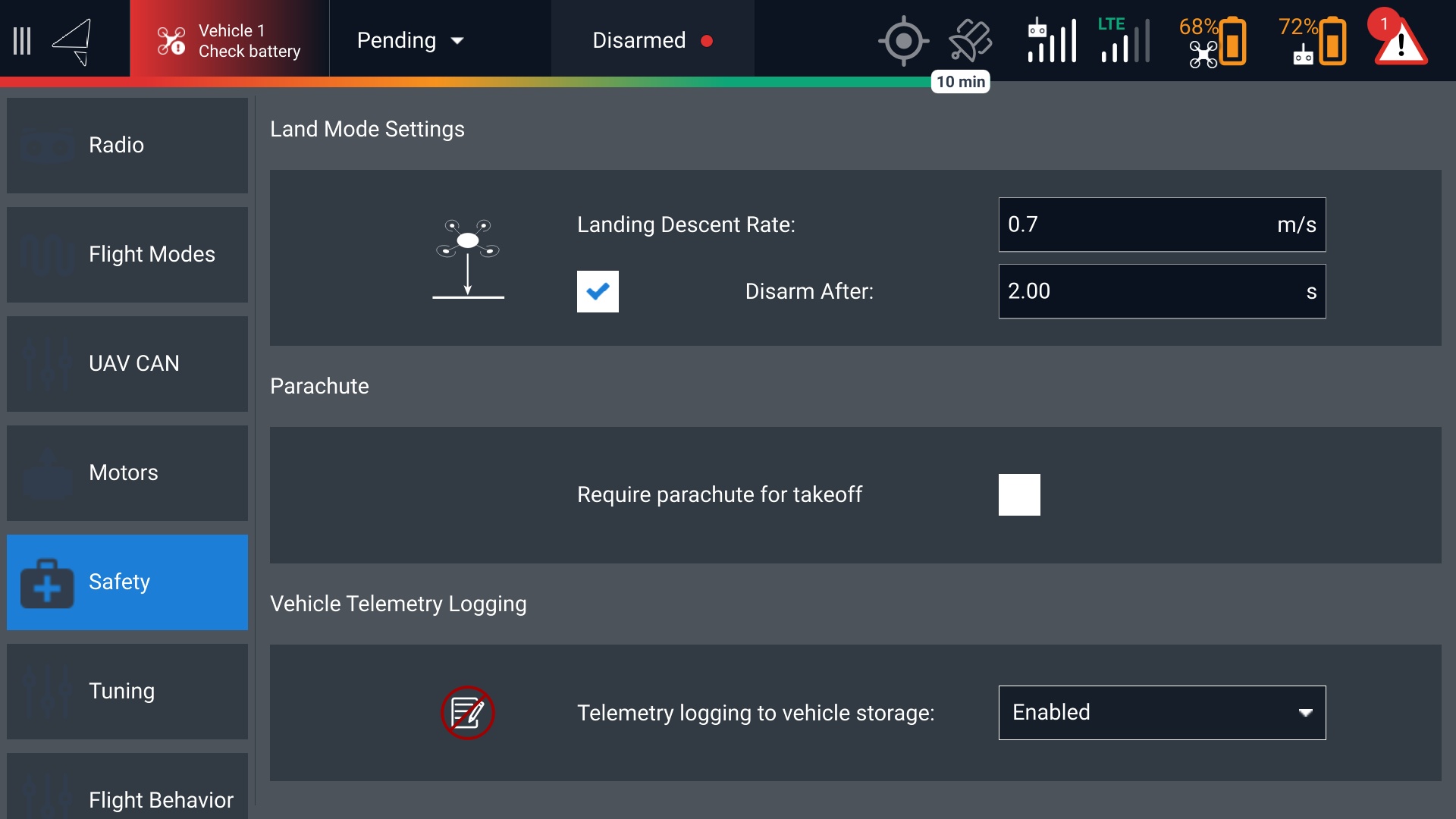

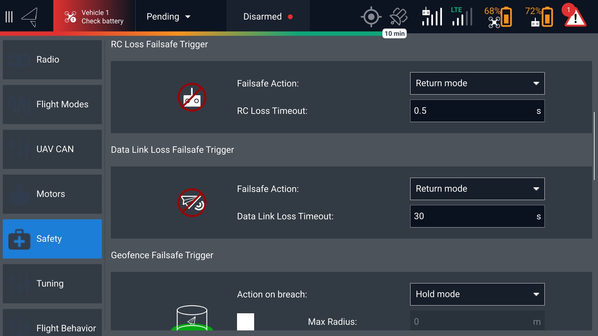

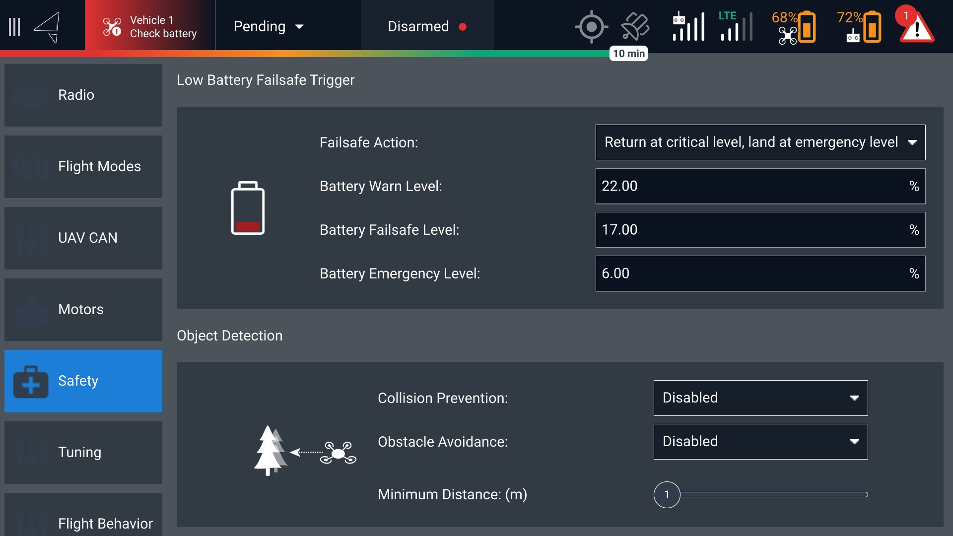

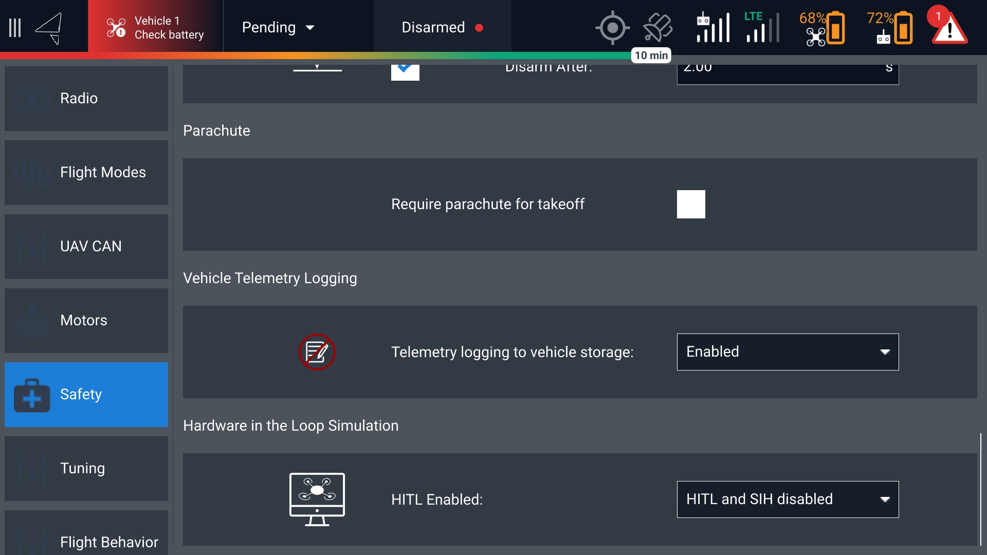

Advanced Safety

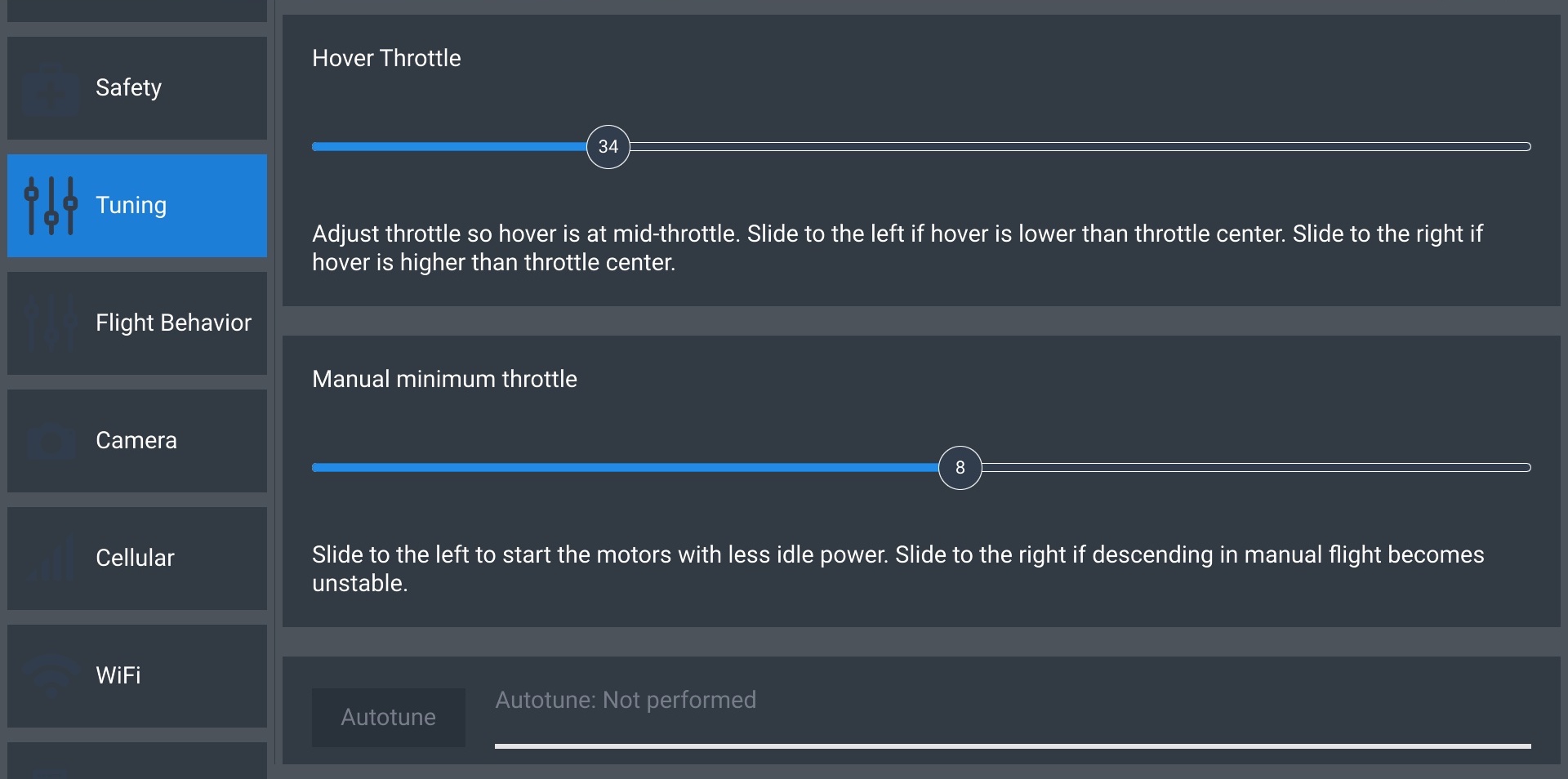

Advanced Tuning
