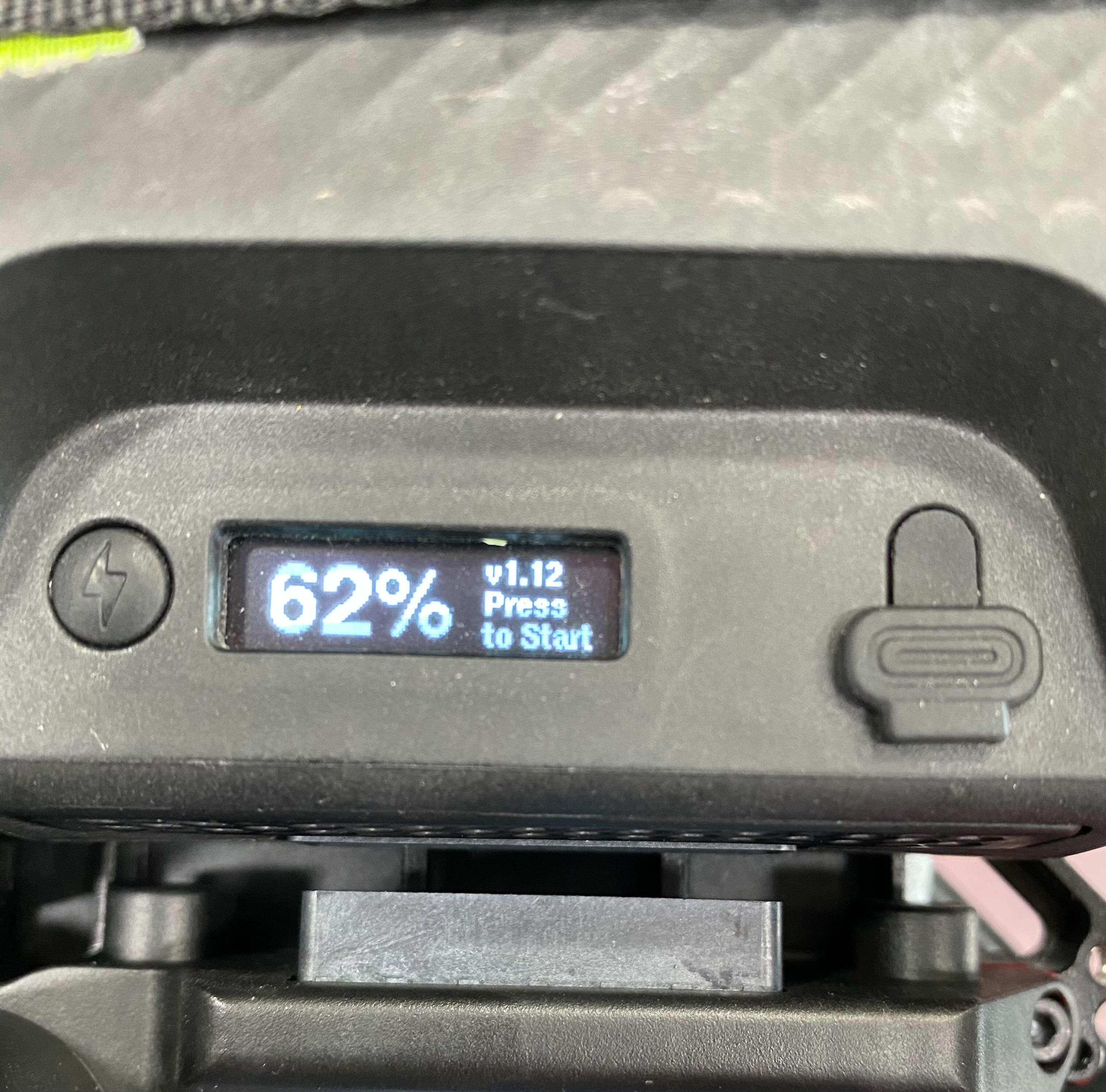

### Checking Battery Firmware
Tap the button on the SL battery while it is powered off to check the current firmware version.
