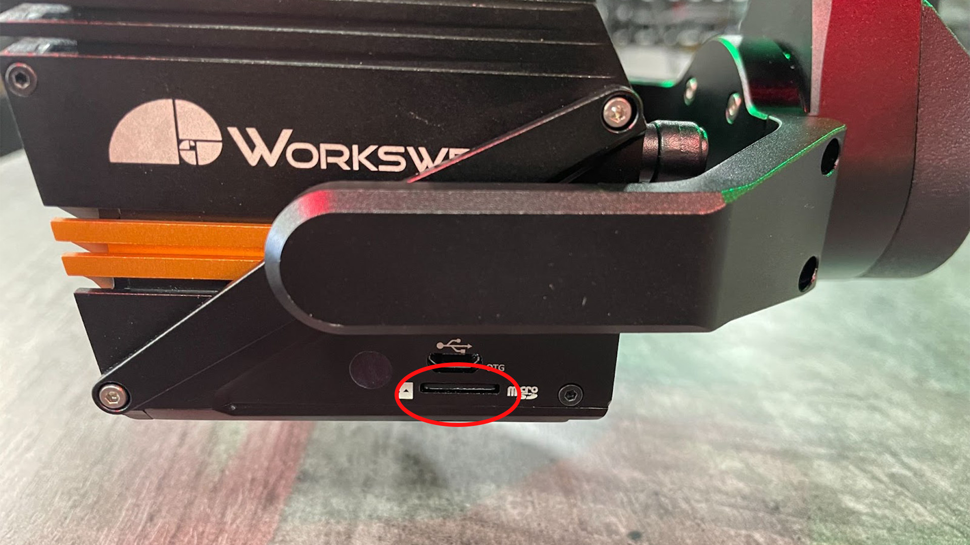

* First remove the micro SD card from the side of the Wiris Pro and insert it into a computer.
<figure><img src="https://2546427254-files.gitbook.io/~/files/v0/b/gitbook-x-prod.appspot.com/o/spaces%2FWXREyAKYAeQJ4gfg2SPg%2Fuploads%2Fgit-blob-0b1652bff020525af2d4b9be680f02ecc0e835e8%2Fsd%20card.png?alt=media" alt=""><figcaption></figcaption></figure>

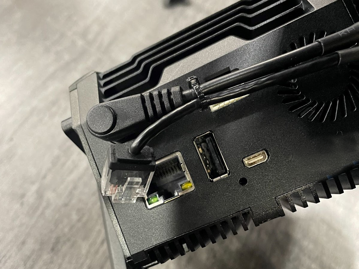

* Remove the ethernet cable from the back of the Wiris Pro.
<figure><img src="https://2546427254-files.gitbook.io/~/files/v0/b/gitbook-x-prod.appspot.com/o/spaces%2FWXREyAKYAeQJ4gfg2SPg%2Fuploads%2Fgit-blob-3982188879a2e498e29d5bc435c2f42d4b3bbfe4%2FIMG_42771%202.png?alt=media" alt=""><figcaption></figcaption></figure>

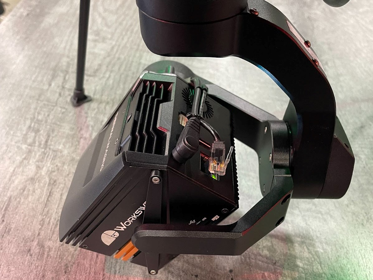

* Attach the gimbal to the aircraft; power on the aircraft and gimbal.
* Tilt the gimbal about 45 degrees down to allow access to the cable ports.
  * Use the Herelink tilt wheel to tilt the gimbal
<figure><img src="https://2546427254-files.gitbook.io/~/files/v0/b/gitbook-x-prod.appspot.com/o/spaces%2FWXREyAKYAeQJ4gfg2SPg%2Fuploads%2Fgit-blob-d7acece8b24ff3e6bf7df184551007411a9ef254%2FIMG_4278%202.png?alt=media" alt=""><figcaption></figcaption></figure>

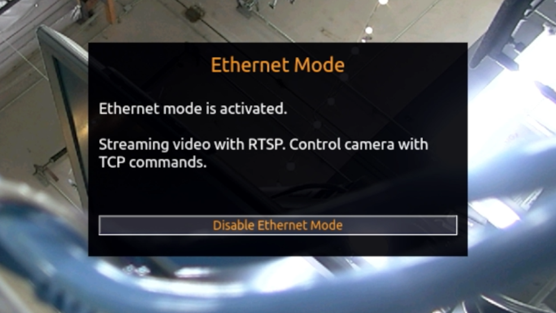

Watch the output on the monitor. Using the arrow keys and enter keys on the keyboard, navigate through the Workswell menu:
* Press Enter to exit Ethernet mode.
<figure><img src="https://2546427254-files.gitbook.io/~/files/v0/b/gitbook-x-prod.appspot.com/o/spaces%2FWXREyAKYAeQJ4gfg2SPg%2Fuploads%2Fgit-blob-dbcc24632b4ce3fc8df5c17565f5205e2703381c%2Fethernet%20(1).png?alt=media" alt=""><figcaption></figcaption></figure>

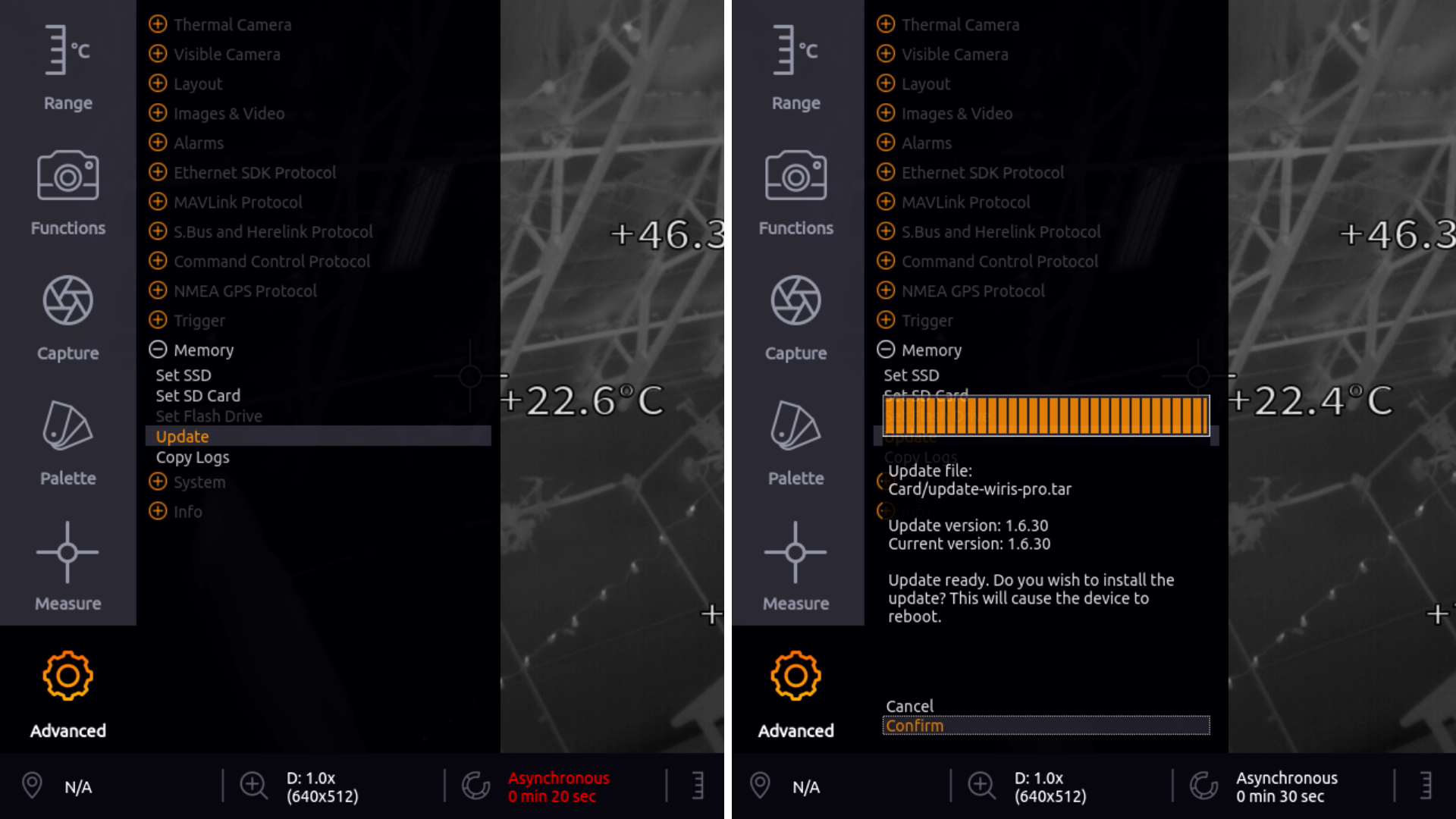

    * Press the down arrow to go to Memory.
    * Press the right arrow to select and then click Enter on Update.
    * Ensure that the UI detects the correct firmware version to upgrade to and press Enter on Confirm.
<figure><img src="https://2546427254-files.gitbook.io/~/files/v0/b/gitbook-x-prod.appspot.com/o/spaces%2FWXREyAKYAeQJ4gfg2SPg%2Fuploads%2Fgit-blob-07aa3379f0667a47125be4e3b4c375e45d74b050%2Fwiris%20update%2011.png?alt=media" alt=""><figcaption></figcaption></figure>
