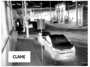

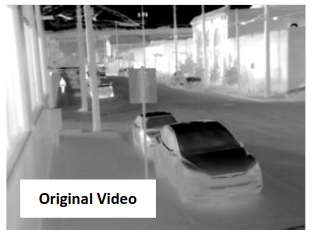

* **Enhancement Mode:**\
  Two different contrast enhancement modes are available: CLAHE and LAP. Once an enhancement mode is selected, additional settings can be configured to configure it.\
  Contrast Limited Adaptive Histogram Equalization (CLAHE) brings out hard-to-see (low contrast) features in the video, including those with brighter and darker areas.<br>
<figure><img src="https://2546427254-files.gitbook.io/~/files/v0/b/gitbook-x-prod.appspot.com/o/spaces%2FWXREyAKYAeQJ4gfg2SPg%2Fuploads%2Fgit-blob-7aaec7667302a96e8994550983091a99d1a796b6%2Fimage%20(156).png?alt=media" alt=""><figcaption></figcaption></figure>
<figure><img src="https://2546427254-files.gitbook.io/~/files/v0/b/gitbook-x-prod.appspot.com/o/spaces%2FWXREyAKYAeQJ4gfg2SPg%2Fuploads%2Fgit-blob-b6ee524c633b48d96d21198831229e52e5f8042e%2Fimage%20(159).png?alt=media" alt=""><figcaption></figcaption></figure>
<br>

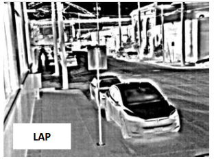

Local Area Processing (LAP) brings out hard-to-see (low-contrast) features. LAP emphasizes differences from the local image average to provide an increased amount of detail in low-contrast areas of a video or image. The algorithm makes details visible in underexposed or overexposed portions of the image.<br>
<figure><img src="https://2546427254-files.gitbook.io/~/files/v0/b/gitbook-x-prod.appspot.com/o/spaces%2FWXREyAKYAeQJ4gfg2SPg%2Fuploads%2Fgit-blob-cd68284f390a368dc581de748c7ba95468ed0a59%2Fimage%20(157).png?alt=media" alt=""><figcaption></figcaption></figure>
* **Strength:**
  * **In CLAHE, the Strength parameter controls the contrast limit**. A larger value allows the algorithm to map a larger contrast but can also tend to bring out more noise.
  * **In LAP, the Strength parameter controls the kernel size used in the processing.** A larger value provides more enhancement. Values are between 0 (minimal enhancement) and 18 (maximum enhancement). For LAP mode, there are no additional enhancement benefits after 18.

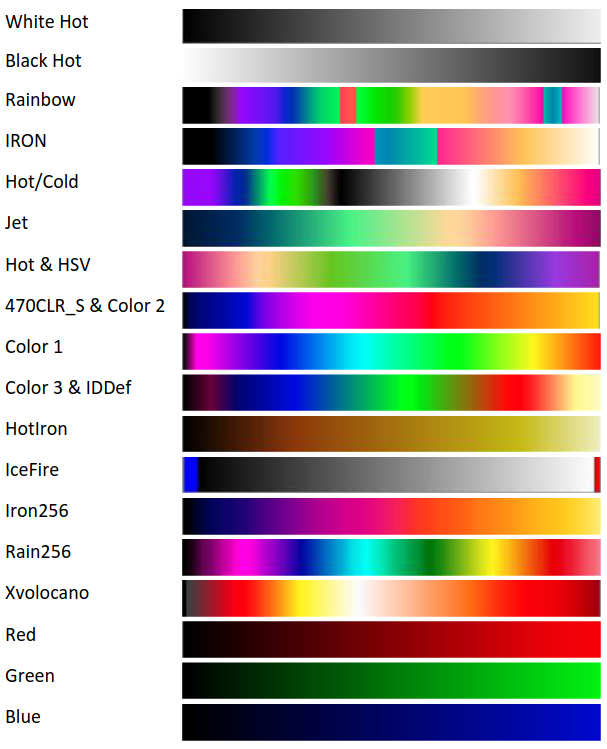

* **Color Palette:**\
  Various false-color palettes may be applied to the video.
  * Options:<br>
    <figure><img src="https://2546427254-files.gitbook.io/~/files/v0/b/gitbook-x-prod.appspot.com/o/spaces%2FWXREyAKYAeQJ4gfg2SPg%2Fuploads%2Fgit-blob-fcc89e1b8279942c62ce422e66b04f3eaef07553%2Fimage%20(160).png?alt=media" alt=""><figcaption></figcaption></figure>
  * **Default:** None
