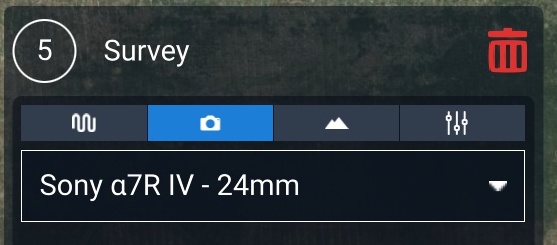

If you plan a mission with a non-standard lens, make sure that the correct lens is selected in the Survey section of the Plan screen. If your lens isn't on the dropdown, you can enter the details manually by selecting Custom Camera instead of a specific lens.

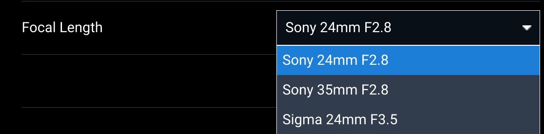

When changing lenses, select your lens from the Focal Length dropdown in Camera Settings found in the camera settings.

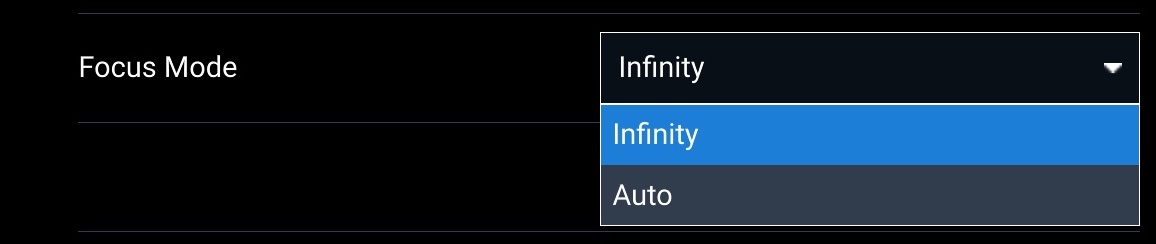

If your lens isn't on the dropdown, pick any lens from that menu and use auto-focus.
