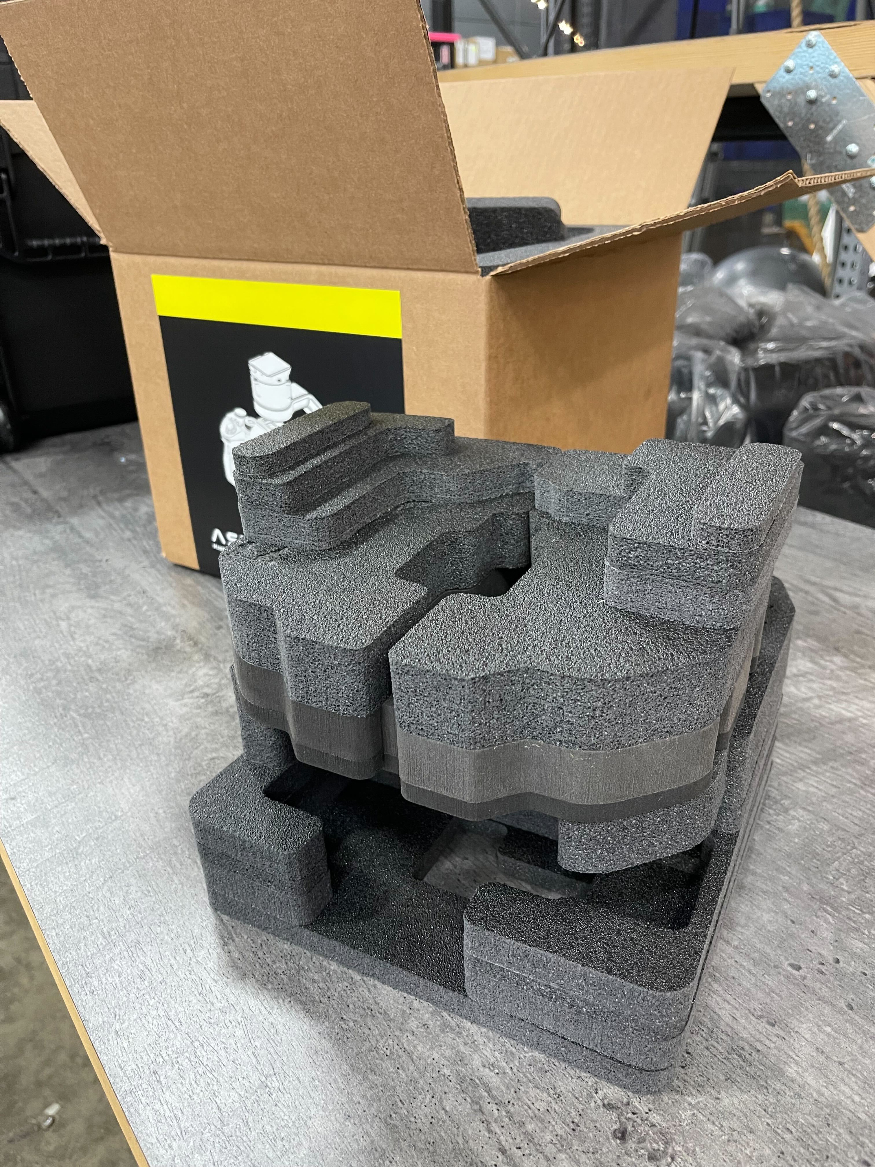

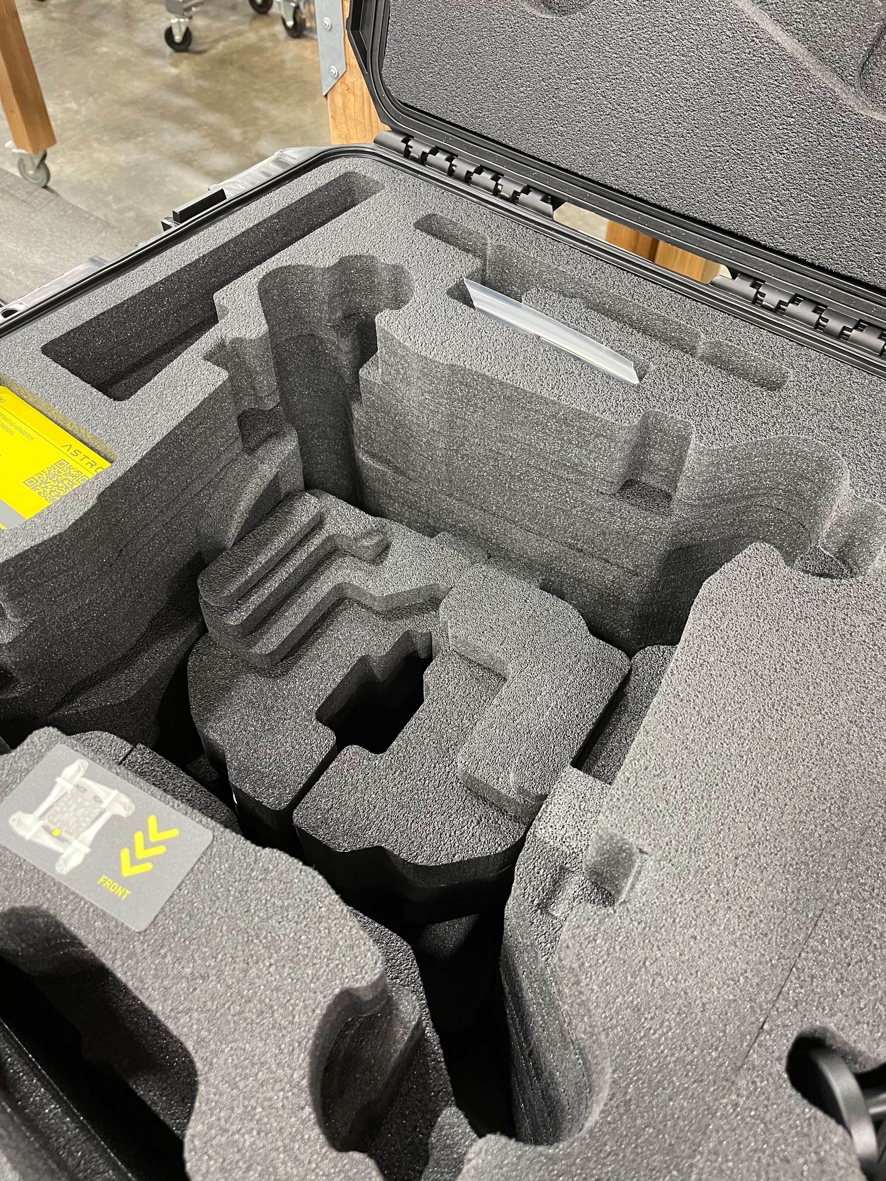

If you purchased the A7R4 Payload by itself make sure to keep the foam it came in. This foam should be transferred to Astro's case so it can continue to protect the mapping payload when it is stored in the case.
<img src="https://2546427254-files.gitbook.io/~/files/v0/b/gitbook-x-prod.appspot.com/o/spaces%2FWXREyAKYAeQJ4gfg2SPg%2Fuploads%2Fgit-blob-f5675638b99051d33262ce05836ee40dd62e83f2%2FImage%20from%20iOS%20(5).jpg?alt=media" alt="" data-size="original"><img src="https://2546427254-files.gitbook.io/~/files/v0/b/gitbook-x-prod.appspot.com/o/spaces%2FWXREyAKYAeQJ4gfg2SPg%2Fuploads%2Fgit-blob-0fdfdb0ffdf4998b5efdabfe8794efbc0e668f6e%2FImage%20from%20iOS%20(4).jpg?alt=media" alt="" data-size="original">
If you purchased an Astro Map then your case already has the gimbal foam installed!
{% endhint %}
