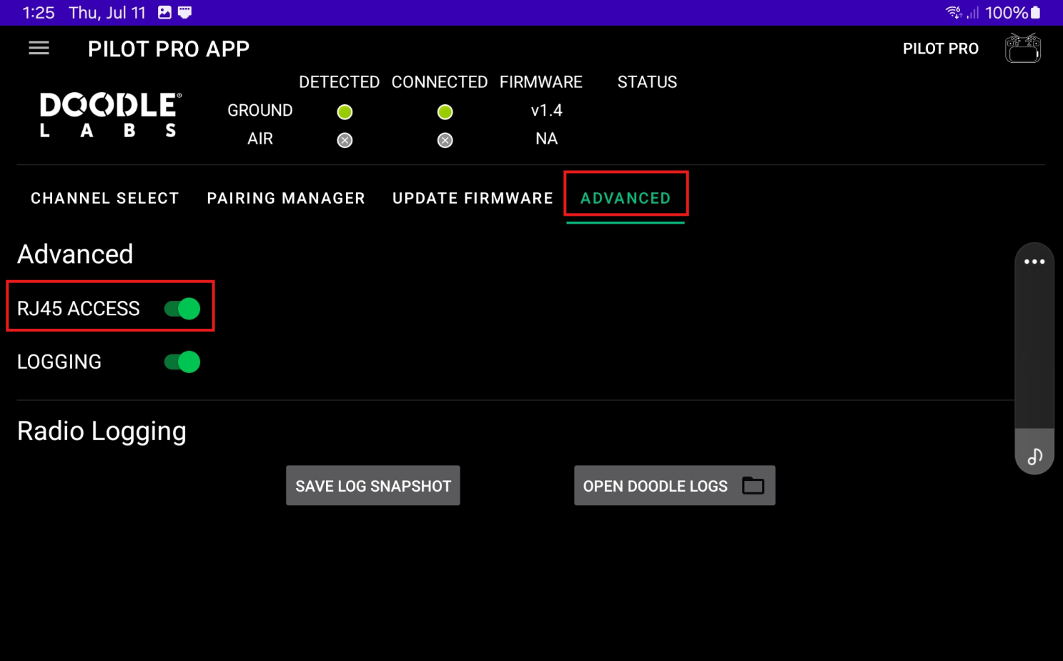

The Doodle Labs Radio Backpack includes an RJ45 ethernet port on the bottom of the module. This interface is disabled by default as a security measure. To instructions below will go over enabling or d
## Enable/Disable Ethernet on the Doodle Labs Module
1. Open the Pilot Pro App and open the side menu
<figure><img src="/files/zHy1OMWCjtfLXpi71Of0" alt=""><figcaption><p>Opening side menu in the Pilot Pro App</p></figcaption></figure>
2. Navigate to 'Radio Settings'
<figure><img src="/files/JTazIFWvqXS0FdONo7jP" alt=""><figcaption><p>Radio Settings location in the Pilot Pro App</p></figcaption></figure>
3. Go to the 'Advanced' tab, and enable/disable RJ45 Access
<figure><img src="/files/U52YlVcib4CPcoWlozum" alt=""><figcaption><p>Enabling/Disabling RJ45 Access for the Doodle Module</p></figcaption></figure>
