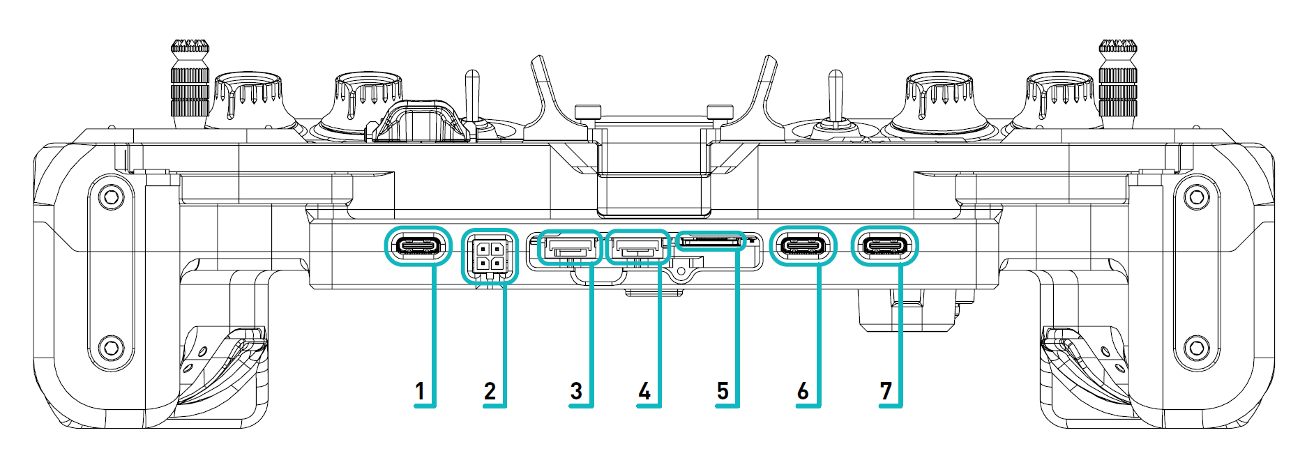

| Connector                             | Information / Pinout                                                                                                                                                                                                                                                                                                                                                                                                                       |
| 1: USB C Charge Input                 | <p>USB C PD Supports up to 100W input<br>No Data</p>                                                                                                                                                                                                                                                                                                                                                                                       |

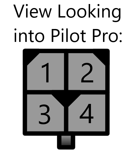

| 2: Molex External Power Input and CAN | <p>5-26V up to 100W input<br>(12V-26V recommended for powering while in use or fast charging)<br><img src="https://2546427254-files.gitbook.io/~/files/v0/b/gitbook-x-prod.appspot.com/o/spaces%2FWXREyAKYAeQJ4gfg2SPg%2Fuploads%2Fgit-blob-352720ee22cde369c89ff5f5288fc2e9d4ad1a37%2Fimage%20(3).png?alt=media" alt=""><br>1 - GND</p><p>2 - Power In</p><p>3 - CAN High</p><p>4 - CAN Low<br><br>Mating Connector: Molex 0430250400</p> |

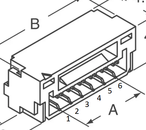

| 3 and 4: JST GH 6-pin                 | <p><img src="https://2546427254-files.gitbook.io/~/files/v0/b/gitbook-x-prod.appspot.com/o/spaces%2FWXREyAKYAeQJ4gfg2SPg%2Fuploads%2Fgit-blob-e10dd11f0936170cb4ba851b117423f8b6c7be8d%2Fimage%20(1).png?alt=media" alt=""><br>1 - GND<br>2 - 5V (1A) Output<br>3 - UART TX (output from Pilot Pro)<br>4 - UART RX (input to Pilot Pro)<br>5 - GPIO<br>6 - GPIO<br><br>Mating Connector: JST GHR-06V-S</p>                                 |
| 5: Micro SD Slot                      | Recommended: SanDisk Ultra microSD or faster                                                                                                                                                                                                                                                                                                                                                                                               |
| 6 and 7: USB C 3.0 Data and Power Out | <p>USB type C Connector<br>5Gbps SuperSpeed<br>5V at 1.5A power output per port</p>                                                                                                                                                                                                                                                                                                                                                        |
