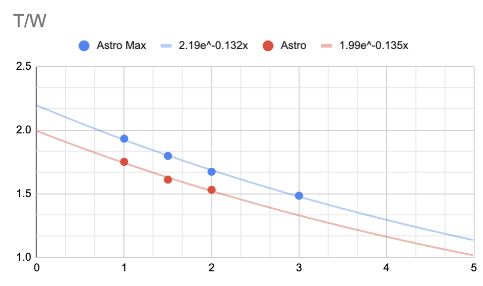

## Thrust To Weight Ratio
### Astro vs Astro Max Comparison

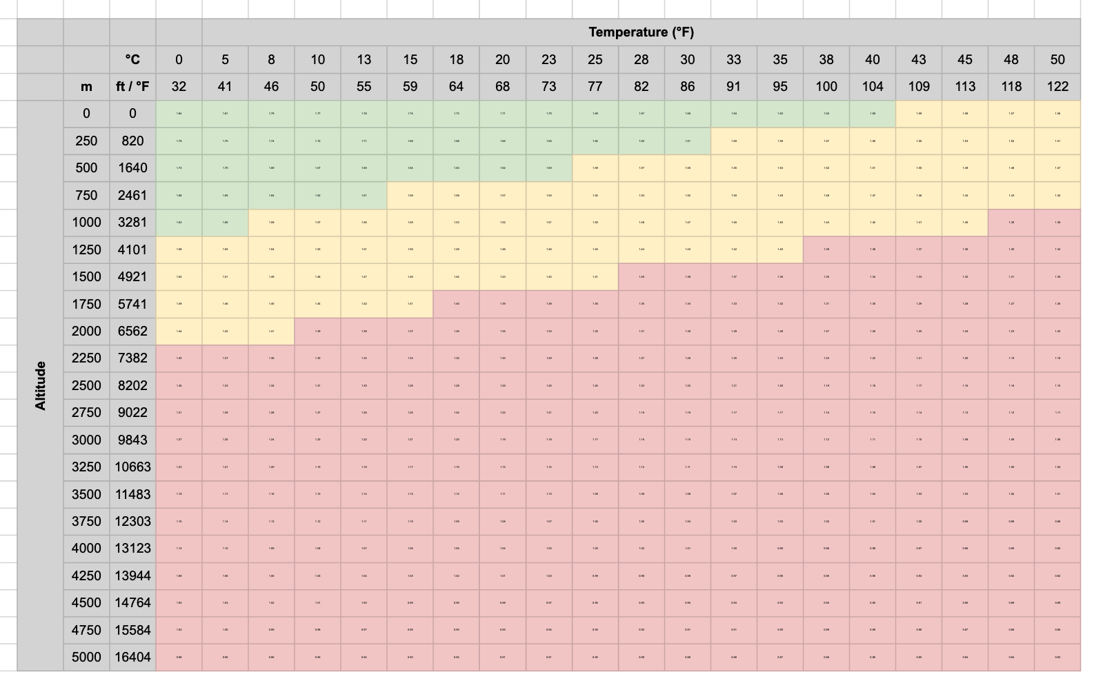

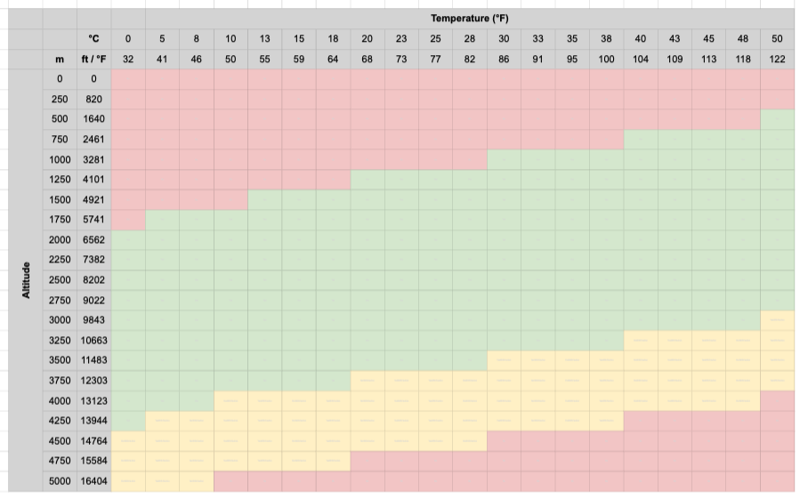

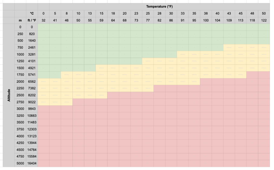

### T/W Performance Charts
* Below T/W Operation Charts are plotted with LR1 Payload as reference.
  * Green: Approved Usage
  * Yellow: Approved usage; performance limited. Imbalanced payload and wind may cause crashes / altitude loss.
  * Red: Prohibited usage.
* Caution: T/W ratio between 1.4 and 1.6 should be flown with caution. These are indicated in yellow in the charts. Imbalanced payload/aircraft in combination with wind may cause crashes. Astro prioritizes its attitude and will lose altitude in these scenarios.
* High Altitude Mode: There are a set of parameters that can be enabled on Astro Max for high altitude flights. (This is not available on original Astro). Read more below.
<figure><img src="https://2177404587-files.gitbook.io/~/files/v0/b/gitbook-x-prod.appspot.com/o/spaces%2F8dwrGJhxGd9cIvsStziq%2Fuploads%2FoEPYUEizzzZMtAKdDnzO%2FScreenshot%202025-07-03%20at%201.53.59%E2%80%AFPM.png?alt=media&amp;token=fac5216c-da54-4eeb-a15a-e10592c1029b" alt=""><figcaption><p>Astro (Original F45)</p></figcaption></figure>
<figure><img src="https://2177404587-files.gitbook.io/~/files/v0/b/gitbook-x-prod.appspot.com/o/spaces%2F8dwrGJhxGd9cIvsStziq%2Fuploads%2FM7TSFLNX95hwrFpFdlIZ%2FScreenshot%202025-07-03%20at%202.07.06%E2%80%AFPM.png?alt=media&amp;token=90d16029-0056-40c3-aaa6-91cab58ff276" alt=""><figcaption><p>Astro Max (Default)</p></figcaption></figure>
<figure><img src="https://2177404587-files.gitbook.io/~/files/v0/b/gitbook-x-prod.appspot.com/o/spaces%2F8dwrGJhxGd9cIvsStziq%2Fuploads%2FUsiTn8msqQhSGn7bBGha%2FScreenshot%202025-07-03%20at%202.08.35%E2%80%AFPM.png?alt=media&amp;token=c0f21fb7-ebcd-4703-9a11-1f4c69faa37c" alt=""><figcaption><p>Astro Max (High Altitude Parameters Enabled)</p></figcaption></figure>

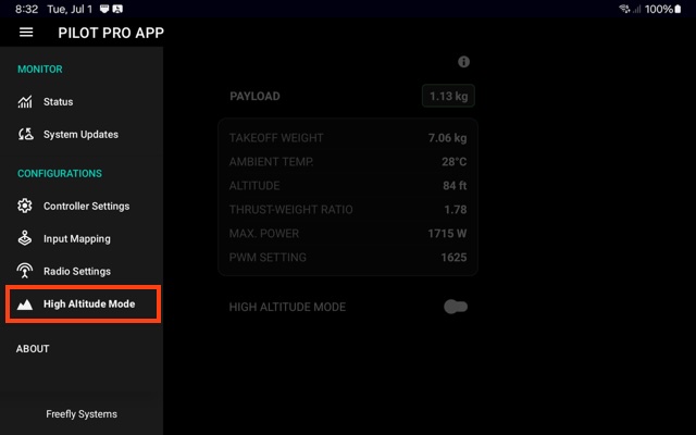

### High Altitude Mode
* **What it is**: A Pilot Pro App feature that enables safe Astro Max operation at high altitudes (up to 15,000 ft / 4,500 m). Astro Max may feel sluggish or have reduced control authority when flying in mountainous terrain or high-density-altitude conditions. This mode increases the motor PWM limits to maintain adequate thrust-to-weight ratio for reliable flight performance.
* **How to use it:**
  1\. Open the Pilot Pro App and connect to Astro Max (not available on original Astro with F45 motors).<br>
  2\. Navigate to Vehicle Applications, and enable vehicle applications. This needs to be toggled every time the Astro reboots.
  <div><figure><img src="https://2177404587-files.gitbook.io/~/files/v0/b/gitbook-x-prod.appspot.com/o/spaces%2F8dwrGJhxGd9cIvsStziq%2Fuploads%2Fl4FKdrVc0mxvguK75X68%2FScreenshot_20260903_114105_Pilot%20Pro%20App.jpg?alt=media&amp;token=80badc23-0352-4362-8f12-0bb2ed646b4a" alt=""><figcaption></figcaption></figure> <figure><img src="https://2177404587-files.gitbook.io/~/files/v0/b/gitbook-x-prod.appspot.com/o/spaces%2F8dwrGJhxGd9cIvsStziq%2Fuploads%2F3GbtRge6DLmwRSQl0rNi%2FScreenshot_20260903_114109_Pilot%20Pro%20App.jpg?alt=media&amp;token=b410d397-49b4-4eee-83fa-bde3b429ce04" alt=""><figcaption></figcaption></figure></div>
  3\. Now that vehicle apps have been toggled on, you will have a new menu item available, called High Altitude Mode. Toggle High Altitude Mode ON before flight at high altitude.<br>
  4\. The app displays a real-time thrust-to-weight estimator to confirm adequate performance margins<br>
  5\. Toggle OFF when returning to normal altitudes.
<div data-full-width="true"><figure><img src="https://2177404587-files.gitbook.io/~/files/v0/b/gitbook-x-prod.appspot.com/o/spaces%2F8dwrGJhxGd9cIvsStziq%2Fuploads%2FiwoCQXmarw9WJUtTVTcv%2Fhigh%20alt%20mode.jpg?alt=media&amp;token=33d2a748-454e-45b1-a977-f042a8114d5d" alt="" width="480"><figcaption></figcaption></figure></div>
* **Requirements:**
  * Astro Max. Legacy Astros with F45 motors are **not** compatible.
  * Pilot Pro App v2.3 or later
  * Astro firmware v2.0.19+
  * Fly in Position Mode with default tuning
* **⚠️ Caution:**
  * This mode is only approved for Position Mode flight. Do not use in Manual or Altitude mode at low elevations, as increased PWM at sea level could stress the power system during aggressive maneuvers.
  * This mode is only approved when flying in position mode with default tuning.

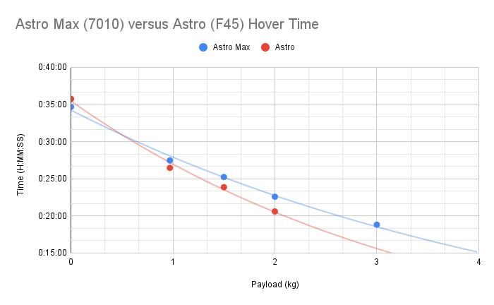

<figure><img src="https://2177404587-files.gitbook.io/~/files/v0/b/gitbook-x-prod.appspot.com/o/spaces%2F8dwrGJhxGd9cIvsStziq%2Fuploads%2FGApaFUPyZmyUwKy7beuj%2FAstro%20Max%20(7010)%20versus%20Astro%20(F45)%20Hover%20Time%20(1).png?alt=media&amp;token=8f85a253-ea1c-400f-98c4-1bda9e3e55da" alt=""><figcaption><p>Conducted at Sea Level and 8C temperature</p></figcaption></figure>

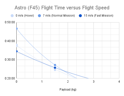

Our flight tests for the Astro (F45) and Astro Max (7010) were conducted by running the batteries from 100% down to 0%. While this is not typical in real-world operations—where a pilot would usually land with some remaining battery for safety—it provides a clear baseline for comparing performance between airframes and payloads. Interestingly, as shown in the “Flight Time versus Flight Speed” chart, hovering draws more power than flying forward at a moderate speed. Because most real flights involve some forward motion (rather than continuous hovering), these 100%–0% hover results end up being a fair representation of typical flights that land with higher battery reserves.
<figure><img src="https://2177404587-files.gitbook.io/~/files/v0/b/gitbook-x-prod.appspot.com/o/spaces%2F8dwrGJhxGd9cIvsStziq%2Fuploads%2FDaeMTwiWbV9C9K6O2Nr0%2FAstro%20(F45)%20Flight%20Time%20versus%20Flight%20Speed.png?alt=media&amp;token=f1e3ce28-d54d-48ae-9223-9f9b2629892e" alt=""><figcaption><p>Conducted at Sea Level and 21C temperature</p></figcaption></figure>
