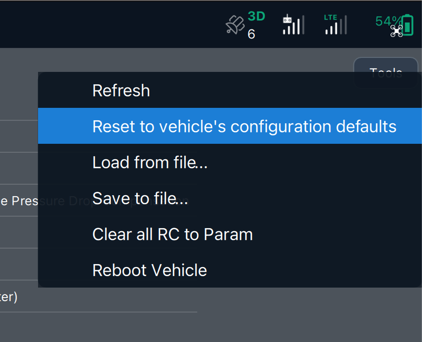

## How to Reset to Default Alta X Gen2 Parameters
* Open AMC and activate Advanced mode
* Connect AMC to Alta X Gen2
* Select: Vehicle setup > Parameters > Tools > Reset to vehicle's configuration defaults.
* Reboot Vehicle
* Calibrate sensors as required
<figure><img src="/files/R5phR2obrURSFx0R5MG6" alt=""><figcaption></figcaption></figure>
